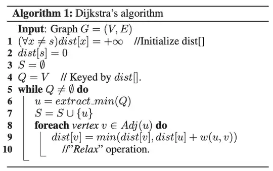

Here is the pseudocode (taken from the cited paper) of DA

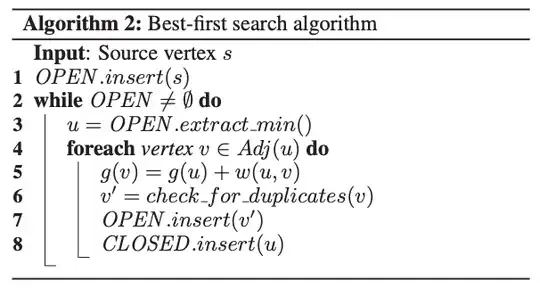

Here is the pseudocode of the best-first search (BFS), of which UCS is just a particular case. Actually, this is the pseudocode of UCS where $g(n)$ is the cost of the path from the source node to $n$ (although the title indicates that this is the pseudocode of BFS).
