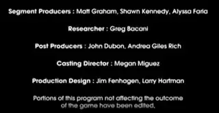

Given a video, I'm trying to classify whether it is a graphical (computer-generated) or realistic scene. For instance, if it contains computer-generated graphics, credit, moving bugs, blue screen, etc. it will be computer-generated graphics, and if it is a realistic scene captured by camera, it will be a realistic scene.
How can we achieve that with AI? Do we have any working solutions available?
Some examples of graphical scenes:
