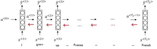

Now in case of RNNs you can unroll the network, and now you can see that it is like a deep network. For clarity look at the image below (taken from a course by Andrew NG and edited):
Red arrows show the way of gradient backpropagation and you can see that in each step they are multiplied by a number (actually a matrix is multiplied in another matrix). If this number is less than one, then it results in vanishing gradient. If this number is greater than one it will result in exposure (which can be controlled by simply clipping it to a max value). The higher the steps, the more of vanishing or exploding effect.
But they have found a solution for this problem, LSTM or GRU. What these units do is that they will make a highway for gradient to backpropagate through (in each state it will be multiplied by 1). So gradient can travel for longer distance (from French into France). Even though, the problem still exists for very long relations.
