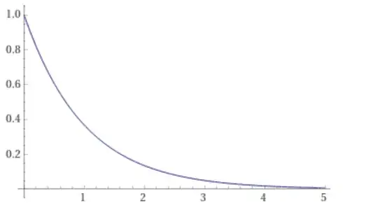

Our goal is to move the robot by getting its current joint configuration c closer to the goal joint angle configuration g (also two dimensional input vector). Hence, the reward I have chosen is e^(-L2_distance(c, g)).
The smaller the L2_distance, the exponentially higher the reward, so I am sure that the robot is properly incentivised to reach the goal quickly.
Reward function (y-axis: reward, x-axis: L2 distance):

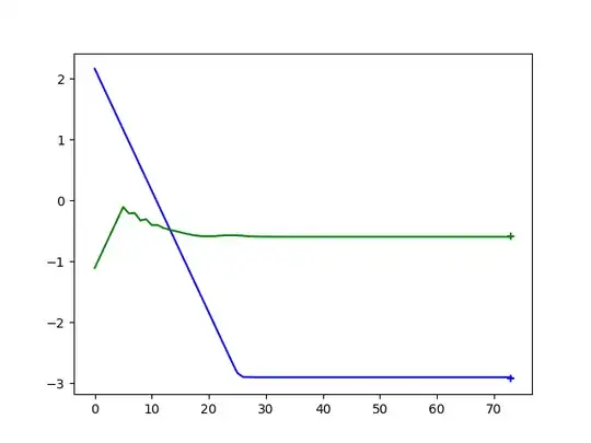

When the robot has only two degrees of freedom, the training quickly converges and the robots learns to solve the task with high accuracy (final L2 distance smaller than 0.01).
Performance of the converged 2D agent. y-axis: joint angle value, x-axis: no of episodes. Crosses denote the desired goal state of the robot.:

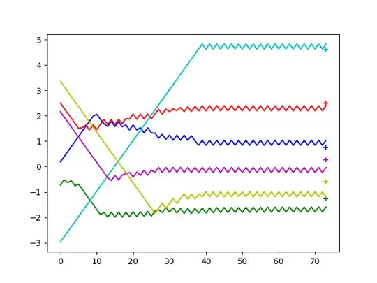

However, if the problem gets more complicated - I increase the joint dimensions to 4D or 6D, the robot initially learns to approach the target, but it never "fine-tunes" its movement. Some joints tend to oscillate around the end-point, some of them tend to overshoot.
I have been experimenting with different ideas: making the network wider and deeper, changing the action step. I have not tried optimizer scheduling yet. No matter how many samples the agent receives or how long it trains, it never learns to approach targets with required degree of accuracy (L2_distance smaller than 0.05).
Performance of the converged 4D agent. y-axis: joint angle value, x-axis: no of episodes. Crosses denote the desired goal state of the robot.:

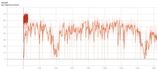

Training curve for 2D agent (red) and 4D agent (orange). 2D agent quickly minimises the L2 distance to something smaller than 0.05, while the 4D agent struggles to go below 0.1.:
