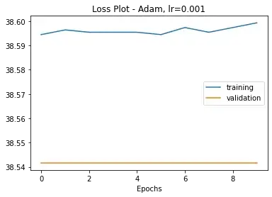

The accompanying loss curve:
![image|378x278](upload://5LXklb7m5pBA7h3gqiQ026DV7BH.png)

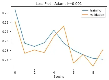

Try 3: Next, I decided to try to implement the paper's idea of reducing the input size to match the output when they don't match: y = F(x, {Wi}) + Mx. I chose average pooling in place of matrix M to accomplish this, and my loss curve became.
The only difference in my code is that I added average pooling so I could use shortcut connections when input and output sizes are different:
