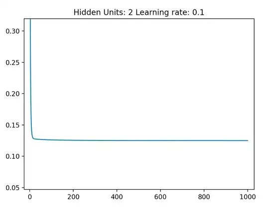

I tried to use 2 hidden ReLU-based unit, 1 output unit to solve the XOR problem and found that gradient will always become really small after training 1000 times.
The Loss vs training times:

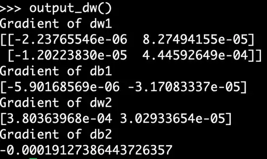

And the gradient looks like:
I think that means the units all dead. The robust way to solve this problem is increase the number of units.

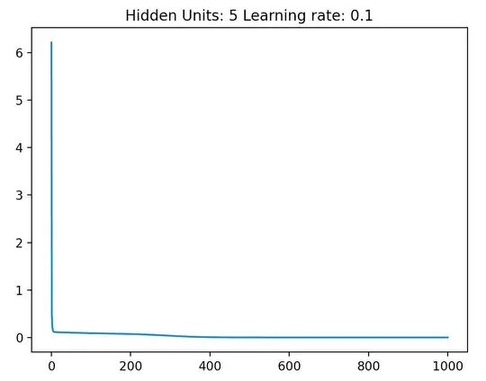

When it comes to 4 units, some times I will success, but sometimes not.
And 5 units, I will fail but the rate decrease.
And so on. That is all.
