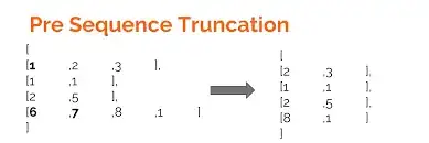

Truncate
This involves reducing the length of all the sentences to the length of the shortest sentence in the corpus. This is generally not done as it reduces the amount of information that we can learn from the corpus. This image shows pre sequence truncation, where we remove from the back to make the sentences of the same length.
Truncate Example
