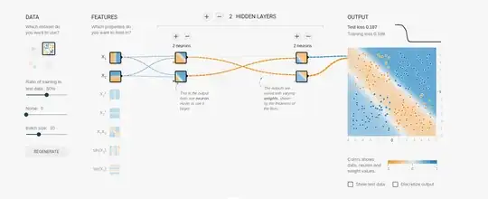

In tensorflow playground for example, I cut the connections (by setting the weight to 0), it just compansated it by changing the other still existing connection a bit more: TensorflowImage
