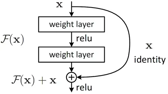

In many diagrams, as seen below, residual neural networks are only depicted with ReLU activation functions, but can residual NNs also use other activation functions, such as the sigmoid, hyperbolic tangent, etc.?

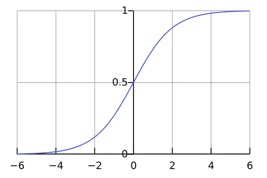

The problem with certain activation functions, such as the sigmoid, is that they squash the input to a finite interval (i.e. they are sometimes classified as saturating activation functions). For example, the sigmoid function has codomain $[0, 1]$, as you can see from the illustration below.
This property/behaviour can lead to the vanishing gradient problem (which was one of the problems that Sepp Hochreiter, the author of the LSTM, was trying to solve in the context of recurrent neural networks, when developing the LSTM, along with his advisor, Schmidhuber).
