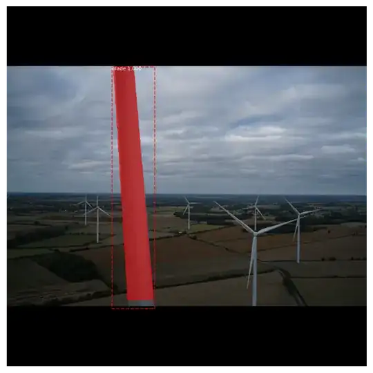

I've been using matterport's Mask R-CNN to train on a custom dataset. However, there seem to be some parameters that i failed to correctly define because on practically all of the images, the bottom or top of the object's mask is cut off: innacurate prediction: mask is cut-off on the bottom
As you can see, the bounding box is fine since it covers the whole blade, but the mask seems to suddenly stop in a horizontal line on the bottom.
On another hand, there is a stair-like effect on masks of larger and curvier objects such as this one (in addition to the bottom and top cut-offs): enter image description here
