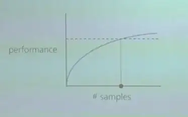

For example, one way to do it would be as shown in the figure below:
  • On the y-axis you have the performance of your RL algorithm (e.g. in terms of average return over episodes as done in [2], or mean total episode reward across different environment runs as done in [3])
  • On the x-axis you have the number of samples that you took.
  • The dashed line corresponds to your performance baseline (e.g. the performance at which a certain game or any other RL environment is considered solved).
So, you can measure sample efficiency at the intersection, where you get the number of samples needed to reach the performance baseline. So, an algorithm that requires less samples would be more sample-efficient.

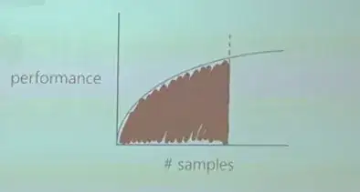

Another way to do it would be the other way around, i.e. the RL agent is provided with a limited budget for the number of samples it could take. As a result, you can measure sample efficiency my measuring the area under the curve, as illustrated below. So, that would be how much performance you got just by using those samples in the budget. An algorithm that achieves a higher performance than another with the same amount of samples would then be more sample efficient.
I am not aware if there exist RL libraries that would provide you with this measure out-of-the-box. However, if you're using Python for example, I believe that using libraries like scipy or scikit-learn along with matplotlib could do the job.
