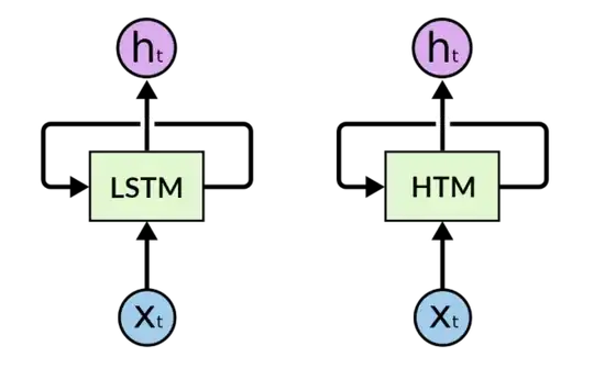

The following figure [1] is inspiring:
It means HTM can be used as a memory unit in different neural networks such as RNN. In the same reference, we can find the following advantages and applications of HTM:
