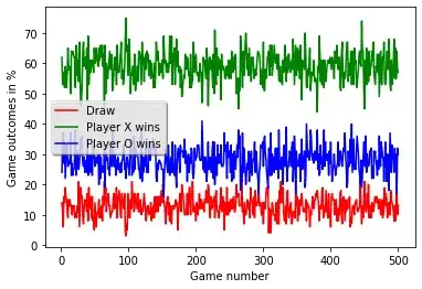

RandomPlayer ("Player X") vs PolicyAgent ("Player O")
So one can see that the Policy Agent is not learning after 500 battles. Each battle consists of 100games against the random player. Together 500 * 100 games.
Can someone tell me the problem or the bug in my code. I can not figure it out. Or what I have to improve. It would be so great.

  • I am of the conviction that policy gradient (in its naive form at least) does not converge for Tic Tac Toe. Looking for confirmation from others.... – Yan King Yin Sep 11 '21 at 04:15

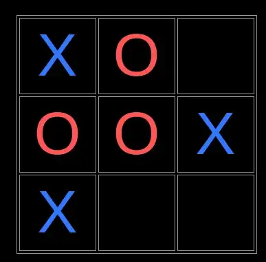

  2. Try to play a few "pre-moves" to make the game easier. For example I start with this (now is for Player 'X' to move):
    Then you may see convergence sooner. Always a good idea to start from a dead-easy case.
  3. Notice that the optimal value is not the "perfect score". If you take win=2, lose=-2, draw=1, then the optimal score for the above game for Player 'X' is 1.5, not 2.0. (You can check the math).

  4. For me it took much more than 50K games to see convergence. It's more like 1-2M games. (Correction: With more trails, I found that policy gradient seems unable to converge to the optimal value, but it did improve over time to reach a sub-optimal score.)
