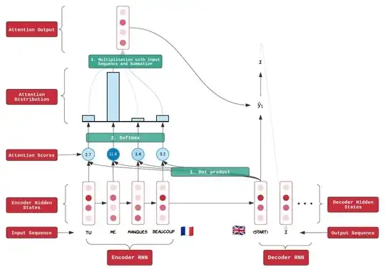

Simply put, the attention mechanism is loosely inspired on well, attention. Consider we are attempting machine translation on the following sentence: "The dog is a Labrador." If you were to ask someone to pick out the key words of the sentence, i.e. which ones encode the most meaning, they would likely say "dog" and "Labrador." Articles like "the" and "a" are not as relevant in translation as the previous words (though they aren't completely insignificant). Therefore, we focus our attention on the important words.
Attention seeks to mimic this by adding attention weights to a model as trainable parameters to augment important parts of our input. Consider an encoder-decoder architecture such as the one Google Translate uses. Our encoder recurrent neural network (RNN) encodes our input sentence as a context vector in some vector space, which is then passed along to the decoder RNN which translates it into the target language. The attention mechanism scores each word in the input (via dot product with attention weights), then passes these scores through the softmax function to create a distribution. This distribution is then multiplied with the context vector to produce an attention vector, which is then passed to the decoder. In the example in the first paragraph, our attention weights for "dog" and "Labrador" would hopefully become larger in comparison to those for the other words during training. Note that all parts of the input are still considered since a distribution must sum to 1, just some elements have more effect on the output than others.
Below is a diagram from Towards Data Science that illustrates this concept very nicely in terms of an encoder-decoder architecture.
