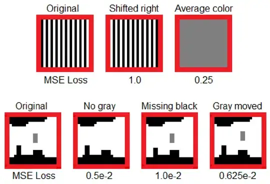

An obvious performance metric would be pixel-wise MSE, but it has its own downsides, shown on some toy examples in an image from paper from Pihlgren et al.
Examples where MSE is not a useful performance metric
In the same paper, the authors suggest using perceptual loss, but it seems complicated and not well-studied.
