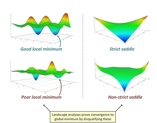

  • It is common during the training of Neural Networks for accuracy to improve for a while and then get worse -- in general, This is caused by over-fitting. It's also fairly common for the Neural Network to "get UNLUCKY and get knocked into a BAD sectors of parameter space corresponding to a sudden decrease in accuracy -- sometimes it can recover from this quickly, but sometimes not.
  • In general, lowering your learning rate is a good approach to this kind of problem. Also, setting a learning rate schedule like FactorScheduler can help you achieve more stable convergence by lowering the learning rate every few epochs. In fact, this can sometimes cover up mistakes in picking an initial learning rate that is too high.
  • you can try using mini-batches.
  • The error (Entropy) with log functions must be used precisely.
