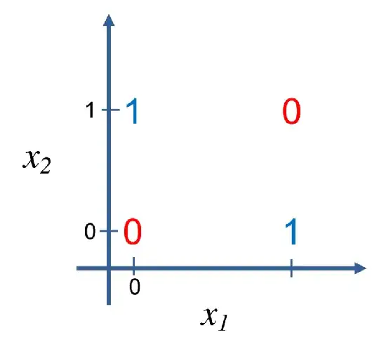

Now lets visualize your dataset, ie plot the points of XOR as a function of X,Y on coordinate space. XOR plot image, [src: https://www.researchgate.net/figure/The-exclusive-or-XOR-function-is-a-nonlinear-function-that-returns-0-when-its-two_fig4_322048911]
Now, whatever you do, you cannot separate the points with a single wx+b straight line, and after passing it to sigmoid, you just squeeze the values for those, ie, a clipped wx+b.
Now, it is still a linear equation. Now when you add another layer, a hidden one, you can operate again on the 1st output, which if you squeeze between 0 and 1 or use something like relu activation, will produce some non linearity, otherwise it will just be (w2(w1*x + b1)+b2, which again is a linear equation not able to separate the classes 0 and 1.
So after adding a hidden layer and passing it through activation function, you get non linear output, example, with sigmoid you get w2*(1/+exp(w2*x+b1))+b2 which has a fairly non linear term of x, and after passing it through sigmoid again, you are able to squeeze the outputs(otherwise they can be higher than 1 or lower than 0,but XOR outputs are binary) after fitting the curve so that both classes are separate.
