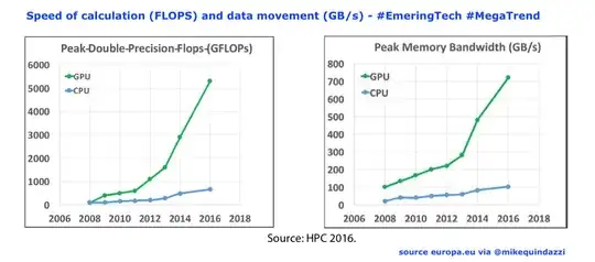

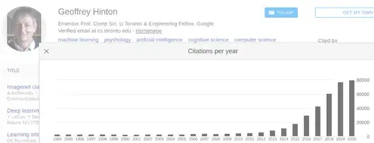

I disagree. Take vanilla deep learning for example (without GANs or any of the other things that came up in the last decade). Hinton and Bengio had been working on deep learning for decades, so why did interest in deep learning suddenly start growing so much from 2011-2014 after a roughly monotonic curve from 1988-2010? Not that this rise started before newer advances such as GANs and DenseNet were developed:
Notice also the similarity between the above graph and these ones:
These days pretty much everyone doing deep learning uses GPUs if they have access to GPUs, and what is possible to accomplish is extremely tied to what computing power a group has. I don't want to undermine the importance of new methods and new algorithms, but GPUs did play a big role for at least some areas of machine learning, such as deep learning.
