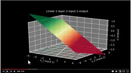

2) As I have 2 weights and 1 bias, actually I am going to plug my inputs to X1*W1+X2*W2=output formula. This is 2d plane in a 3d space if I am not mistaken(time-code 5:31): 2d plane in 3d space
Thus when I plug in my variables, like in regression I will get on a Z axis my output. So the second question is: am I right up to here?

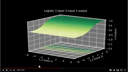

3) My output (before I plug it into the activation function) is just a simple number, IT IS NOT A PLANE and NOT A SURFACE, but a simple scalar, without any sigh on it coming from 2d surface in a 3d space(though it does come from there). Thus, when I plug this number (which was Z value in a previous step) into the activation function (say sigmoid) my number enters there in to the X axis, and we get as an output some Y value. As I understand this operation was totally 2d operation, is was 2d sigmoid and not some kind of 3dsigmoidal surface.
So here is the question: If I am right, why do we see in this movie (and couple of other places) such an explanation? (time-code 12:55): 3d-sigmoidal surface

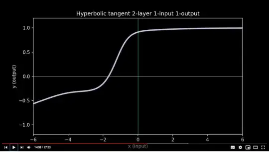

4)Now lets say that I was right in the previous step and as an output from the activation function I do get a simple number not a 2d surface and not a 3d one. I just have some number like I had in the very beginning of the ANN as an input (age, education etc). If i want to add another layer of neurons, this very number enters there as is not telling any one the "secret" that it was created by some kind of sigmoid. In this next layer this number is about to take similar transformations as it happened to age and education in a previous layer, it is going to be Xn in just the same scenario: sigmoid(XnWn+XmWm=output) and in the end we will get once again just a number. If I am right, why in the movie they say (time-code 14:50 ) that when we add together two activation functions we get something unlinear. They show result of such "addition" first as 2d (time-code 14:50 and 14:58). addition of 2 activation functions So, Here comes my question: how come that they "add" two activation functions, if to the second activation function reaches just a simple number as said above he is not telling any one the "secret" that it was created by some kind of sigmoid.

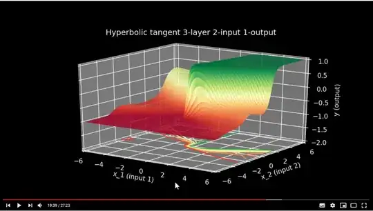

5) And then again, they show this addition of 3d surfaces (time-code 19:39 )
19:39 How it is possible? I mean again there should not happen any addition of surfaces, because no surface passes to next step but a number. What do I miss?

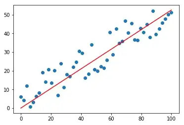

Linear Regression
A Linear Regression
In the above figure, we clearly have one independent variable on the x-axis, and one dependent variable on the y-axis. The red line has an intercept of zero, and let's say a slope of 0.5. Therefore, $$ y = 0.5x + 0 $$
This, right here, is a single perceptron. You take a value of x, lets say 8, pass it through the the node, and get a value as output, 4. Simple! But what is the model in this case? Is it the output? No. Its the set [0.5, 0] that represents the red line above. The outputs are simply points on that line.

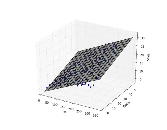

The plots in your question, do not represent outputs. They represent the models. But now that you've possibly understood what a linear model with one indpendent variable looks like, I hope you can appreciate that having 2 independent variables will give us a plane in 3-D space. This is called multiple regression.
multiple regression
This forms the first layer of a neural network with linear activation functions. Assuming $ x_{i} $ and $ x_{j} $ as the two independent variables, the first layer computes $$ y_{1} = w_{1}x_{i} + w_{2}x_{j} + b_{1} $$
Note that while $ y_{1} $ is the output of the first layer, the set $ [w_{1}, w_{2}, b_{1}] $ is the model of the first layer and can be plotted as a plane in 3D space. The second layer, again a linear layer, computes $$ y_{2} = w_{3}y_{1} + b_{2} $$

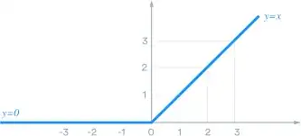

Yes, adding linear layers to a neural network is absolutely useless. But what happens if the activation functions of each perceptron, each layer was not linear? For example the sigmoid or the most widely used today, ReLU.
Compounding non-linear functions on non-linear functions can increase non-linearity.

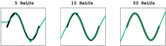

The ReLU looks like this $$ y = max(0, x) $$ relu
This is definitely non-linear but not as non-linear as let's say the sine wave. But can we approximate the sine wave by somehow "compounding" multiple, say $ N $ ReLUs?
$$ \sin(x) \approx a + \sum_{N}b*max(0, c + dx)$$
And here the variables $ a, b,c, d $ are the trainable "weights" in neural network terminology.
sinx_as_relu
If you remember the structure of the perceptron, the first operation is often denoted as a summation over all the inputs. This is how non-linearity is approximated in Neural Networks. Now one may ask: So, summing over non-linear functions can approximate any function, right? So a single hidden layer between input layer and output layer (one that sums over all the outputs of the hidden layer units) should be enough? Why do we often see neural network architectures with so many hidden layers? This is one of the most important yet often overlooked aspect of neural networks and deep-learning.

The output of any node is simply a scalar number. For a given input you get a specific scalar output. What is being shown is the surfaces that get generated as you VARY x1 and x2 over their input range. To answer your first question it is always best to scale your inputs.
