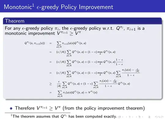

I was going through university slides and this particular slide is trying to prove that in a Monte Carlo Policy Iteration algorithm using an epsilon-greedy policy, the state Values (V-Values) are monotonically improving.
My question is about the first line of computation.
Isn't this actually the formula for the expected value of Q? It is calculating a probability of occurrence following the policy times actual Q values, then doing the summation.
If that is the case, could you help me understand the relationship between the expected value of Q and the expected value of V ?
Also, if above is true, in a real world scenario, depending on how many episodes we sample and on stochasticity, does it mean that the V values of the new policy could be worse than the V values of the old policy ?

I think this equation answer your question: $$ q_{\pi^{i}}(s,\pi^{i+1}(s)) = \mathbf{E}[q_{\pi^{i}}(s,\pi^{i+1}(s))] = \sum_{a \in A}\pi^{i+1}(a|s)q_{\pi^{i}}(s,a)$$
value of the Q while taking action from policy $\pi^{i+1}$ and thereafter following the policy $\pi^{i}$ is equal to the expected q value while taking action from policy $\pi^{i+1}$ and thereafter following the policy $\pi^{i}$. And for the second part of your question the answer is:
$$ V_{\pi^{i}}(s) = q_{\pi^{i}}(s,\pi^{i}(s))$$
state Value function following the policy $\pi^{i}$ is the same as action-value function while taking action from policy $\pi^{i}$ and thereafter following the policy $\pi^{i}$.
