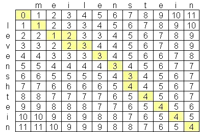

General Levenshtein distance for character level shown in below fig. enter image description here
