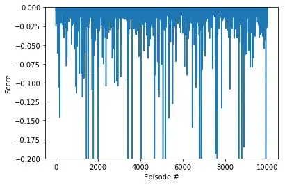

I've been trying to use DDPG with a set of "commonly used" hyperparameters (as I have no idea have to tune them besides experimenting which lasts too long) but so far (after 10000 episodes) it seems that nothing is happening.
