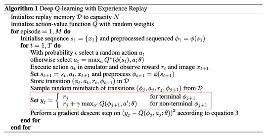

The deep Q-learning (DQL) algorithm is really similar to the tabular Q-learning algorithm. I think that both algorithms are actually quite simple, at least, if you look at their pseudocode, which isn't longer than 10-20 lines.
Here's a screenshot of the pseudocode of DQL (from the original paper) that highlights the Q target.

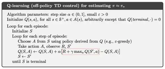

Here's the screenshot of Q-learning (from Barto and Sutton's book) that highlights the Q target.
In both cases, the $\color{red}{\text{target}}$ is a reward plus a discounted maximum future Q value (apart from the exception of final states, in the case of DQL, where the target is just the reward).

Apart from that, the logic of both algorithms is more or less the same, so, if you know Q-learning (and you should know it before diving into DQL), then it shouldn't be a problem to learn DQL (if you also have a decent knowledge of deep learning).
