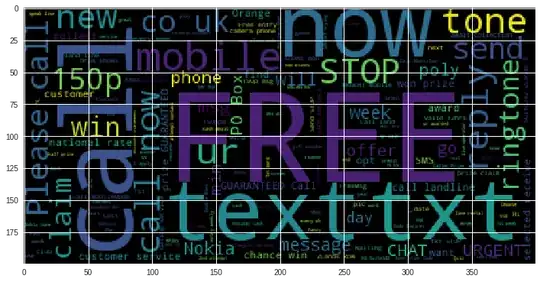

After preprocessing the text enter image description here
From the above WordCloud, we can find the most frequent(occurred) words like
Free
Call
Text
Txt
As these are the most frequent words and adds less importance in prediction/classification as they appear a lot. (My Opinion)
My Question is Removing top frequent(most occurred) words will improve the model score?
How does this impact on model performance?
Is it ok to remove the most occurred words?

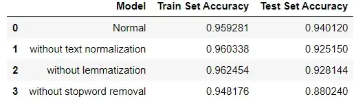

Based on your question, "is removing top frequent words (stopwords) will improve the model score?". The answer is, it depends on what kind of stopwords are you removing. The problem here is that if you do not remove stop words, the noise will increase in the dataset because of words like I, my, me, etc. Here is the comparison of those three aspects using SVM Classifier.
Comparison using SVM Classifier
You may see that without stopwords removal the Train Set Accuracy decreased to 94.81% and the Test Set Accuracy decreased to 88.02%. But, you should be careful about what kind of stopwords you are removing.
If you are working with basic NLP techniques like BOW, Count Vectorizer or TF-IDF(Term Frequency and Inverse Document Frequency) then removing stopwords is a good idea because stopwords act like noise for these methods. If you working with LSTM’s or other models which capture the semantic meaning and the meaning of a word depends on the context of the previous text, then it becomes important not to remove stopwords.
