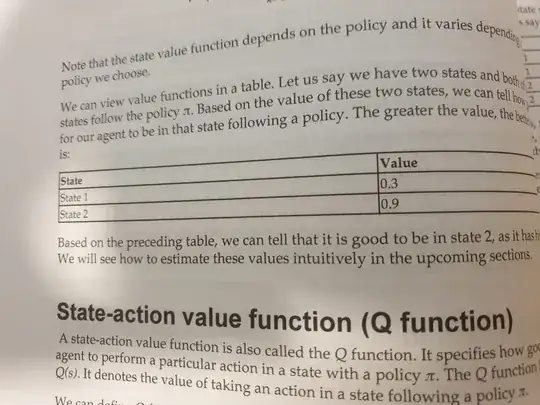

I'm a beginner in the RL field, and I would like to check that my understanding of certain RL concepts.
Value function: How good it is to be in a state S following policy π. Value function
So, the value functions here are 0.3 and 0.9

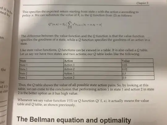

Q function(also called state-action value, or just action value): How good it is to be in a state S and perform action A while following policy π. It uses reward to measure the state-action value
So, the state-action values here are 0.03,0.02,0.5 and 0.9

Value function: How good it is to be in a state $s$ following policy $\pi$.
There are different value functions. There's the state value function, often denoted as $v(s)$ (or $V(s)$), so it's a function of only one variable, i.e. $s$ (a state). There's the state-action value function $q(s, a)$ (or $Q(s, a$)). A value function is a function, so it's not a number or a vector, or whatever. It's a function, so it maps inputs to outputs. In the first case, it maps states to real numbers. In the second case, it maps states and actions to real numbers. So, we could denote the state value function as $v : \mathcal{S} \rightarrow \mathbb{R}$ (where $\mathcal{S}$ is the set of states in your environment) and state-action value function as $q : \mathcal{S} \times \mathcal{A}\rightarrow \mathbb{R}$ (where $\mathcal{A}$ is the set of actions and $\times$ means "combination of").
So, your definition of a value function is not quite correct. The value function $v(s)$ doesn't represent "how good it is to be in a state $s$ following a policy $\pi$", but "how good it is to be in a state $s$ AND THEN following policy $\pi$". To emphasize this, you often use the notation $v_{\pi}(s)$ rather than simply $v(s)$.
See What are the value functions used in reinforcement learning? for more details about existing value functions in reinforcement learning. And to see the full definition of the value functions, I suggest you read Sutton and Barto's book.
Q function (also called state-action value, or just action value): How good it is to be in a state $s$ and perform action $a$ while following policy $\pi$. It uses reward to measure the state-action value
As I said above, the $q$ function is a "value function" too. It's just a different value function than $v$.
Again, the same thing I said for $v$ also applies here, so "how good it is to be in a state $s$ and perform action $a$ while following policy $\pi$" is incorrect for the same reason your definition for $v$ was incorrect. The $q$ function can be defined as "how good it is to be in a state $s$ and take action $a$, AND, AFTER THAT, follow a given policy $\pi$. Again, to emphasize that $q$ is defined in terms of $\pi$, we often use the notation $q_\pi$.

I think most of it is correct.
This is a bit off. Q function basically tells you how good it is to be in state S and perform action A, and follow policy $\pi$ from the next state onwards. The action A that you take can be any action from the action space and need not be according to the policy $\pi$.
Also, I think Q-function and Q-value are mostly used interchangeably to mean the same thing.
