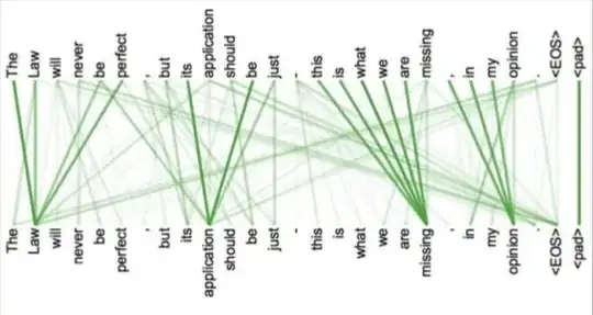

In the paper, the authors explain the attention mechanisms saying that the purpose is to determine which words of a sentence the transformer should focus on. I personally prefer to think of attention as a sort of coreference resolution step. The reason why I think so is the following image (taken from this presentation by the original authors).
This image shows basically the result of the attention computation (at a specific layer that they don't mention). Bigger lines connecting words mean bigger values in the dot product between the words query and key vectors, which means basically that only those words value vectors will pass for further processing to the next attention layer. But, please, note that some words are actually related even if not similar at all, for example, 'Law' and 'The' are not similar, they are simply related to each other in these specific sentences (that's why I like to think of attention as a coreference resolution). Computing similarities between embeddings would never provide information about this relationship in a sentence, the only reason why transformer learn these relationships is the presences of the trained matrices $\mathbf{W_q}$, $\mathbf{W_v}$, $\mathbf{W_k}$ (plus the presence of positional embeddings).
