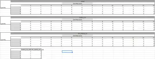

The input to the NN is a $4 \times 41$ NumPy array of binary values (0, 1) representing the MCTS players hand, MCTS face-up cards, OP face-up cards, MCTS no. face-down cards, OP no. face-down cards. Shown below.
Describes the np.array:
The np.array is made from the database entries of game states. An example of this information is below. However, I am currently omitting the TOP & DECK_EMPTY columns in this model. WON (0, 1) is used as the label.
