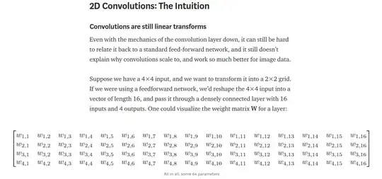

The image above, a screenshot from this article, describes discrete 2D convolutions as linear transforms. The idea used, as far as I understand, is to represent the 2 dimensional $n$x$n$ input grid as a vector of $n^2$ length, and the $m$x$m$ output grid as a vector of $m^2$ length. I don't see why this can't be generalised to higher-dimensional convolutions, since a transformation matrix can be constructed from one vector to another, no matter the length (right?)
My question: Aren't all discrete convolutions (not just 2D) linear transforms?
Are there cases where such a transformation matrix cannot be found?

Short answer, Convolution is a linear operator (check here) but what you are defining in context of CNN is not convolution, it is cross-correlation which is also linear in case of images (dot product).

So these are the actual definitions of convolution. It has linearity property (clearly obvious since it is used to calculate output of LTI system), and it also has the linearity in terms of matrix multiplications, since we want to do the computer to do these calculations for us. I don't know a lot but there are many clever manipulations e.g the FFT algorithm an indispensable tool in signal processing (used to convert signals to frequency domain for a certain sampling rate). Like this you can define convolutions in terms of Hermitian matrices and stuff (only if you want to process in the $n$ domain it is much easier to process in the frequency domain).
For example a $1D$ circular convolution between 2 signals in $n$ domain defined in matrix form, can be written as follows $y_n=h_n*x_n$: where $$y_t = \begin{bmatrix} y_0 \\ y_1 \\ y_2 \\ y_3 \end{bmatrix} = \begin{bmatrix} h_0 & h_3 & h_2 & h_1\\ h_1 & h_0 & h_3 & h_2\\ h_2 & h_1 & h_0 & h_3 \\ h_3 & h_2 & h_1 & h_0 \end{bmatrix} \begin{bmatrix} x_0 \\ x_1 \\ x_2 \\ x_3 \end{bmatrix}$$

When we move to $2D$ domain similar equation is formed except (in $n$ domain)instead of $h_0$ we will have a Hermitian matrix $H_0$ and we will perform the Kronecker product (I don't know the justification or proofs of these equations, it probably satisfies the convolution theorem and is fast when ran on computers). Again much easier to do in frequency domain.
When we move to multiple dimensions, it is called Multidimensional discrete convolution as per this Wikipedia article. As the article suggests the property where everything is in frequency domain. $$Y(k_1,k_2,...,k_M)=H(k_1,k_2,...,k_M)X(k_1,k_2,...,k_M)$$ still holds good. When we do convolutions in the $n$ domain things get tricky and we have to do clever matrix manipulations as shown in the example above. Whereas, as stated above things get much easier in the frequency domain.

Now whether it can be represented by matrix products in $n$ domain or not I cannot say. But generalising, it should be possible, only it will involve increasingly complex matrix properties and operations.

The convolutions are linear transformations. However in typical applications a non linear activation function like RELU is used following the convolution to provide non-linearity otherwise a convolutional neural network would just be a net linear transformation.
