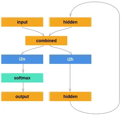

What I currently struggle with is sending multiple time-steps-states to the NN. The reason for this is the complexity of how the game/program I am using. According to Deep Recurrent Q-Learning for Partially Observable MDPs LSTM could be a solution for this, however I would prefer to manually code a RNN rather than using an LSTM. Would not a RNN with something like the following structure have a chance of working?
Also, as far as I know, RNN need the inputs to be fed in sequence and not randomly sampled?
