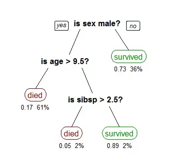

One solution to this could involve a fusion of a decision tree and ANN for a multilevel classification.
A decision tree can help with predicting the possible category of the instance to classify. Then, the ANN at the leaves of the tree can produce the final classification.
For example, in image recognition, the tree can decide what category of object to identify (eg., landscape, people, vehicles, etc.) and the ANN for the appropriate type can predict exactly what object it is. In vehicles, for example, car, bus, bike, etc.
