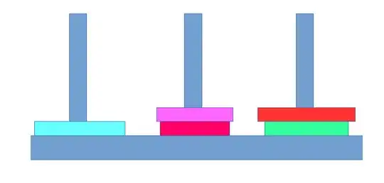

Puzzle:
Tower of Hanoi
There are 3 posts. Each has rings on it. From bottom to top on each post. The first post has the second largest ring. The second post has the smallest ring, with the second smallest ring on top of it. The third post has the third largest ring, with the largest ring stacked on top of it.

I'm really at a loss here. Thank you!
