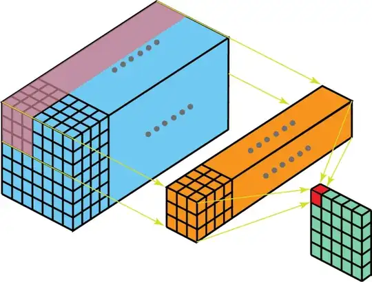

If the 2d convolutional layer has $10$ filters of $3 \times 3$ shape and the input to the convolutional layer is $24 \times 24 \times 3$, then this actually means that the filters will have shape $3 \times 3 \times 3$, i.e. each filter will have the 3rd dimension that is equal to the 3rd dimension of the input. So, the 3rd dimension of the kernel is not given because it can be determined from the 3rd dimension of the input.
2d convolutions are performed along only 2 axes (x and y), hence the name. Here's a picture of a typical 2d convolutional layer where the depth of the kernel (in orange) is equal to the depth of the input volume (in cyan).
Each kernel can optionally have an associated scalar bias.
At this point, you should already be able to calculate the number of parameters of a standard convolutional layer. In your case, the number of parameters is $10 * (3*3*3) + 10 = 280$.

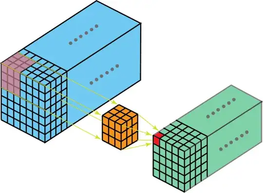

For example, in the case of 3d convolutions, the kernels may not have the same dimension as the depth of the input, so the number of parameters is calculated differently for 3d convolutional layers. Here's a diagram of 3d convolutional layer, where the kernel has a depth different than the depth of the input volume.
See e.g. Intuitive understanding of 1D, 2D, and 3D convolutions in convolutional neural networks.
