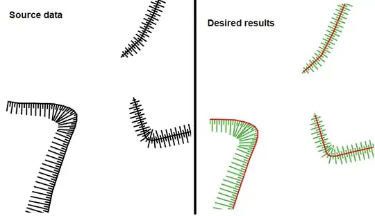

I have a task of classifying spatial data from a geographic information system. More precisely, I need a way to filter out unnecessary line segments from the CAD system before loading into the GIS (see the attached picture, colors for illustrative purposes only).
The problem is that there are much more variations of objects than in the picture. The task is difficult to solve in an algorithmic way.
