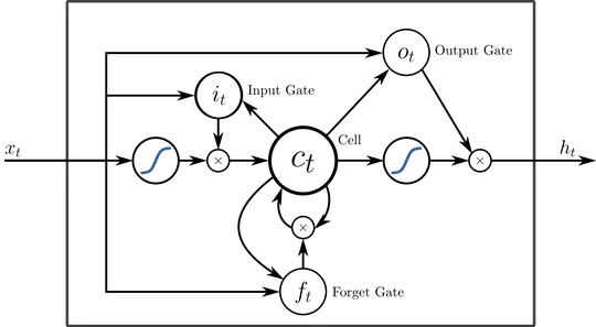

Here's a typical representation (or diagram) of an LSTM (more precisely, an LSTM with a so-called peephole connection).
This can actually represent both an LSTM unit (and, in that case, the variables are scalars) or an LSTM layer (and, in that case, the variables are vectors or matrices).
You can see from this diagram that an LSTM unit (or layer) is composed of gates, denoted by
  • $i_t$ (the input gate: the gate that regulates the input into the unit/layer),
  • $o_t$ (the output gate: the gate that regulates the output from the unit)
  • $f_t$ (the forget gate: the gate that regulates what the cell should forget)
and recurrent connections (e.g. the connection from the cell into the forget gate and vice-versa).
It's also composed of a cell, which is the only thing that a neuron of a "vanilla" RNN contains.

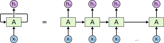

Given the presence of cyclic connections, any recurrent neural network (either an LSTM or not) may be represented as a graph that contains one or more cyclic connections. For example, the following diagram may represent both a standard/vanilla RNN or an LSTM neural network (or maybe a variant of it, e.g. the GRU).
