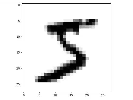

However, I think the kind of normalization applied in this case is incorrect. The image before was:
Original image

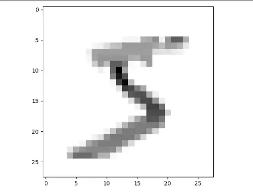

After the normalization it is
Normalized image
As we can see, some pixels which were black before have become grey now. Columns with few black pixels before result in black pixels. Columns with many black pixels before result in lighter grey pixels.

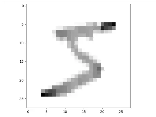

This can be confirmed by applying the normalization on a different axis:
Normalization applied to a different axis
Now, rows with few black pixels before result in black pixels. Rows with many black pixels result in lighter grey pixels.

You could rank every pixel in terms of brightness before normalization and after to verify that the ranks are preserved. Correct normalization would preserve the ranks. From the pictures 1 and 2, it seems that the ranks were not preserved (e.g. the top right pixels went from grey to black).
The tutorial's normalization is done incorrectly: x_train is a an array of 2D images, but the normalization was applied along the first axis. What happened is that each column of every image was normalized relatively to itself (compare image 1 and 2 column-wise – the ranks were preserved). The normalization should have been applied along the second axis – that would normalize every pixel relative to the image it's in. In seems that incorrect normalization wasn't enough to sabotage the learning though! Your proposed normalization should work fine.
