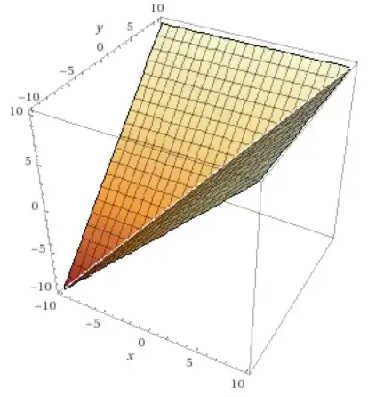

Here's a plot (computed with Wolfram Alpha) of the maximum between two numbers (so it is clearly a function of two variables, hence the plot is 3D).
Note that, in this plot, both variables, $x$ and $y$, can linearly increase, as opposed to having one of the variables fixed (which I used only to give you a simple and hopefully intuitive example that the maximum is not a linear function).
In the case of convolution networks, although max-pooling is a non-linear operation, it is primarily used to reduce the dimensionality of the input, so that to reduce overfitting and computation. In any case, max-pooling doesn't non-linearly transform the input element-wise.

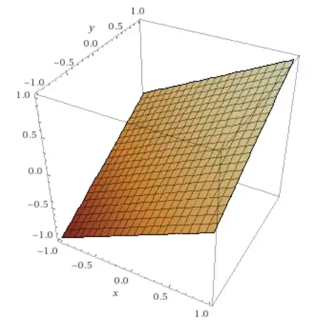

The average function is a linear function because it linearly increases with the inputs. Here's a plot of the average between two numbers, which is clearly a hyperplane.
