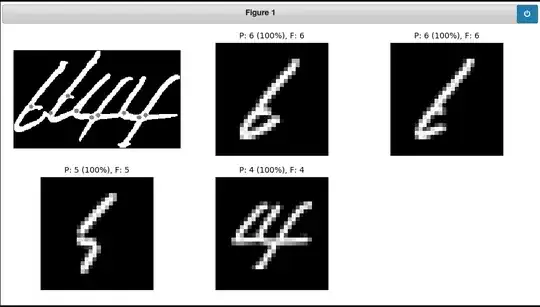

This came from me applying a heuristic algorithm for segmentation of sequences of connected digits. In the image above, the left part is actually a 4, and the right is the curve bit of a 2 without the base. The algorithm is supposed to step through segment cuts, and when it finds a confident match, remove that cut and continue moving along the sequence. It works really well for some cases, but of course it's totally reliant on being able to tell if what it's looking at is not a good match for a digit. Here's an example of where it kind of did okay.
Various input images for handwritten digit recognition
My next best option is to do inference on all permutations and maximise combined score. That's more expensive.

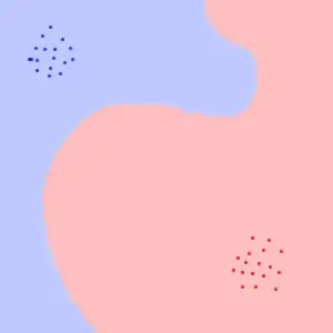

First, lets see how trivial neural network classifies 2D input into two classes : enter image description here

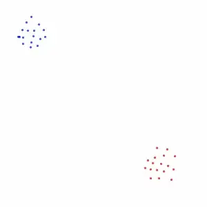

But in case of complex neural network, the input space is much bigger and the sample data points are much more clustered with big chunks of empty space between them:

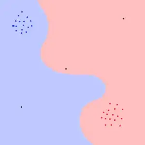

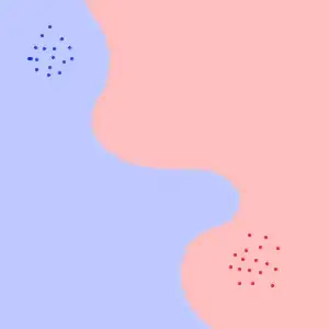

The neural network then doesn't know how to classify the data in the empty space, so something like this is possible :
When using the traditional ways of measuring quality of neural networks, both of these will be considered good. As they do classify the classes themselves correctly.
Then, what happens if we try to classify these data points?
Really, neural network has no data it could fall back on, so it just outputs what seems to us as random nonsense.
