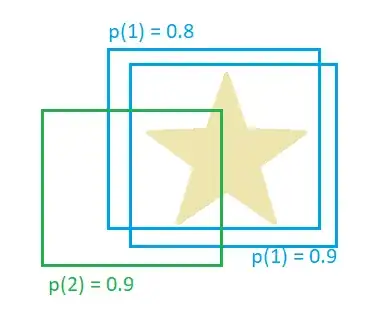

Here is an example, where we have:
  • Two classes $c \in [c_1, c_2] = [$ "star"$, $ "moon" $]$
  • Three bounding boxes
The blue bounding boxes holds prediction for the class $c_1$ so their predictions are $p(c_1)_{box1} = 0.8$ and $ p(c_1)_{box2} = 0.9$. On the other hand, the green box holds a prediction for the class $c_2$.
The three boxes are highly overlaping so the overlap between any box $x$ with any box $y$ will be above the IoU threshold: $IoU(box_x, box_y) > 0.5$. So in principle all boxes are suceptible to be removed.
However the NMS only applies for boxes predicting the same class (in the case the blue one). So the NMS algorihtm is: if the boxes are overlapping, $IoU(box_1, box_2) > 0.5$, which is true, remove all non maximal class probability boxes. Said differently, take just the box with highest $p(c_1)$ and remove the rest. So the $box_1$ with class probability $p(c_1) = 0.8$ would be removed.
So what happens with green box? Isn't it overlapping as well? Yes, but consider that the green box is not trying to predict the same object, is trying to predict another object, $c_2$, which happens to be very close to the first object, $c_1$. This way object detectors support detection of different overlapping objects.
