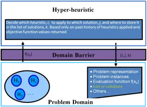

The way that this has traditionally been implemented was via the introduction of the 'hyper-heuristic domain barrier' (see figure, below), whereby generality across problem domains is claimed to be achievable by preventing the solver from having knowledge of the domain on which it is operating. Instead, it would solve the problem by operating only on opaque integer indices into a list of available heuristics (e.g. in the manner of the 'Multi-armed Bandit Problem').
Traditional notion of Selective Hyper-heuristic
In practice, this 'domain blind' approach has not resulted in solutions of sufficient quality. In order to achieve results anywhere comparable to problem-specific metaheuristics, hyper-heuristic researchers have had to implement complex problem-specific heuristics, thereby failing in the goal of rapid prototyping.
It is still possible in principle to create a selective hyper-heuristic solver which is capable of generalizing to new problem domains, but this has been made more difficult since the above notion of domain barrier means that only a very limited feature set is available for cross-domain learning (e.g. as exemplified by a popular selective hyper-heuristic framework).
