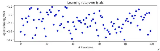

Here's the learning rate: enter image description here

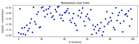

Here's the momentum: enter image description here
I won't add a graph, but the batch size is also sampled from one of 32, 64, or 128. Also note that I did this with a fixed 10 epochs in each trial.
I understand that we'd expect the trialled parameters to converge gradually towards the optimal, but why the longer term movement of the average?

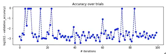

For context here is the score (1 - accuracy) over iterations enter image description here
