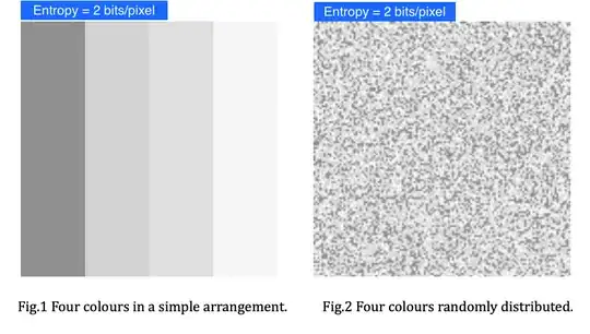

  2. Entropy is a useful measure of information content when you assume each sample is iid, but this would be a very bad assumption to make for natural images, since they are highly structured. For example, imagine an image with 50% black pixels and 50% white pixels that can be arranged in any configuration - not matter how you arrange them, wether it looks like random noise, a text paragraph, or a chequer board, the entropy value will be identical for each, even though our intuition tells us otherwise (see attached image). The discrepancy between our intuition and the entropy value arises because our intuition does not interpret the image through the "lens" of iid pixels, but rather, hierarchical receptive fields in the visual cortex (somewhat analogous to convolutional neural networks).
