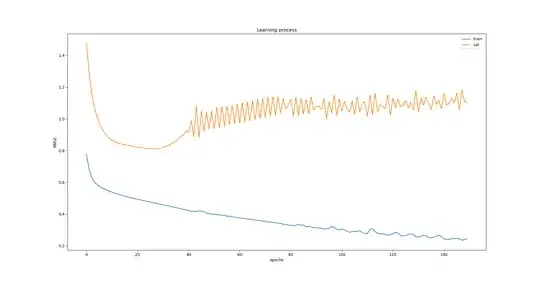

I am working on a project that requires time-series prediction (regression) and I use LSTM network with first 1D conv layer in Keras/TF-gpu as follows:
model = Sequential()
model.add(Conv1D(filters=60, activation='relu', input_shape=(x_train.shape[1], len(features_used)), kernel_size=5, padding='causal', strides=1))
model.add(CuDNNLSTM(units=128, return_sequences=True))
model.add(CuDNNLSTM(units=128))
model.add(Dense(units=1))
As an effect my model is clearly overfitting: enter image description here

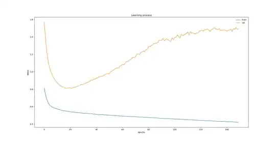

So I decided to add dropout layers, first I added layers with 0.1, 0.3 and finally 0.5 rate:
model.add(Dropout(0.5))
However I think that it has no effect on the network learning process, even though 0.5 is quite large dropout rate: enter image description here
Is this possible that dropout has little/no effect on a training process of LSTM or maybe I do something wrong here?

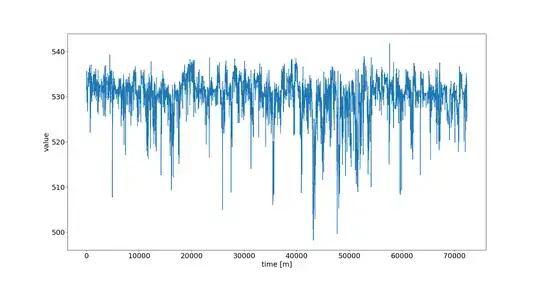

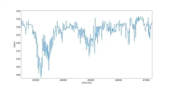

[EDIT] Adding plots of my TS, general and zoomed in view. enter image description here enter image description here
I also want to add that the time of training increases just a bit (i.e. from 1540 to 1620 seconds) when I add the dropout layers.

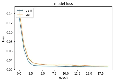

Model without Dropout
# Generate LSTM network
model = tf.keras.Sequential()
model.add(LSTM(4, input_shape=(1, previous)))
model.add(Dense(1))
model.compile(loss='mean_squared_error', optimizer='adam')
history=model.fit(X_train, Y_train, validation_split=0.2, epochs=20, batch_size=1, verbose=2)
Over 20 epochs, the model achieves a validation loss of 0.0267 without Dropout.
loss without dropout

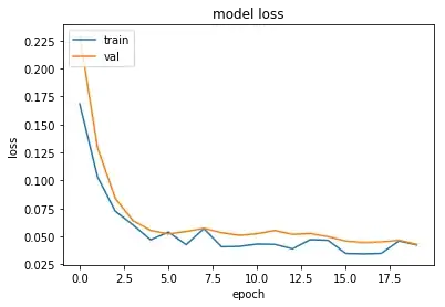

Model with Dropout
model.add(Dense(1))
However, validation loss is slightly higher with Dropout at 0.0428.
loss with dropout
