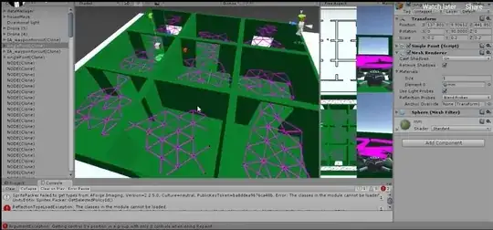

In my bachelor thesis I was implementing a very similar algorithm on a drone on Unity3D. You can find the package here. You can get an idea out of it.
Here is a video of how it worked: https://youtu.be/Xrh9-4Bfcew
