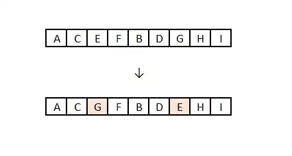

Interchange mutation
The concept is pretty basic: to mutate an ordered genome you just swap two elements. Easy.

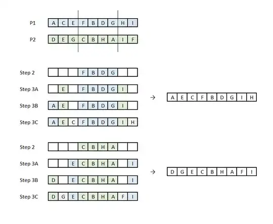

PMX Variation Crossover
This is a bit more complicated as we have to take repetitions into account. From experience, I like to use this variation of the Partially Mapped Crossover. It is way easier to implement than the original one (you can find the paper online) but it will cost some more computational complexity. Longer the genome, higher the price you will pay.
  1. Start by selecting two parents to use for the crossover.
  2. From the first parent (P1) select a random section that will be passed over.
  3. For the remaining values:
    3A. If they are not in the copied section, take them from P2
    3B. If they are in the copied section, take them from P1
    3C. End up filling the gaps with the missing values in the order they are in P1

You can lower down the complexity of the crossover to O(n) (from O(n*n)) simply using a hashmap that keeps track of the genes already added to child.
To get the first child call PMX2Crossover(P1, P2); and for the second just swap the parents PMX2Crossover(P2, P1);
