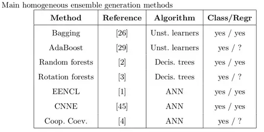

Table ? This means that there are not promising versions of this algorithm fro regression until 2012. After your question, I have found one of the survey research paper which is done or ensemple methods for regression. This table also extracted from this paper. Read this paper, it will help you a lot more
