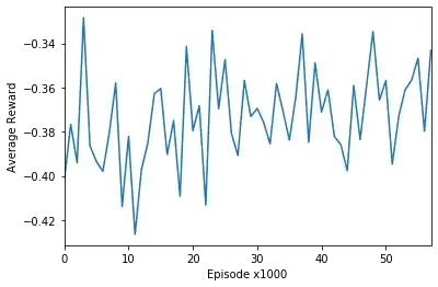

Training progress
Is it because the Banana-v0 rewards are not predictable? I.e. whether the banana sells or not is still determined by a random number (with success chance based on the price).
Where should I take it from here? How to identify which Coach agent algorithm I should start with and try to tune it?
