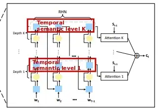

EDIT: I took some time reading the paper. I think "semantic levels" refers here to the different neural networks layers used for the exogenous features.
Here is a modified version of their figure I've drawned to make it clearer: enter image description here
In particular, from what I have understood so far, the attention coefficients apply to the whole semantic level (which I find not really clearly indicated on their figure)
The LHS of their figure would then be better described by this new one:
Hope this helps!
