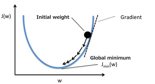

In Machine(or Deep) Learning, Convergence means an initial weight moves towards the global minimum of a function by gradient descent as shown below:
