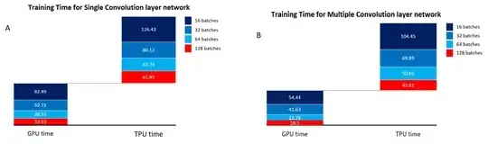

Here is the paper that analyzed CNN model performance for the three-image processing application in GPU/TPU platforms in Colab for various batch sizes. The analysis was done by varying the final feed-forward network and the hidden layers, and this gives an inference on how the performance is affected when the model structure changes
one Fig(a): Training time for single and multiple convolutional layer networks.
In the paper, analysis was done using a single convolutional layer followed by all other layers for the mask detection application for binary class, and the training time was analyzed for GPU and TPU for both networks. The training time increases when the convolutional layers are removed because the number of nodes gets more, and thereby training time increases. The training time for Single layer convolution and multiple-layer Convolution for different batch sizes is shown in Fig(a).
The analysis clearly shows that the time decreases when the number of convolutions increases due to a reduction in the number of nodes. The training time is less for the multiple layers CNN compared to single-layer CNN and also with an increase in the batch size.

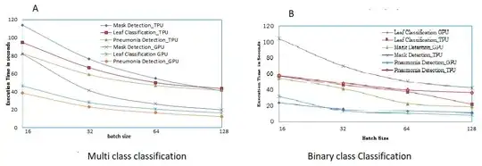

two Fig(b): Execution time for multi and binary classes.
The overall training time for each of the three applications was in GPU and TPU for both binary, and multiple classifications were analyzed and shown in Fig(b).
From Fig(b), it is clear that compared to TPU, GPU has a low time for execution of the CNN. This occurs due to the bottleneck that occurs in TPU due to the in-between CPU access.
