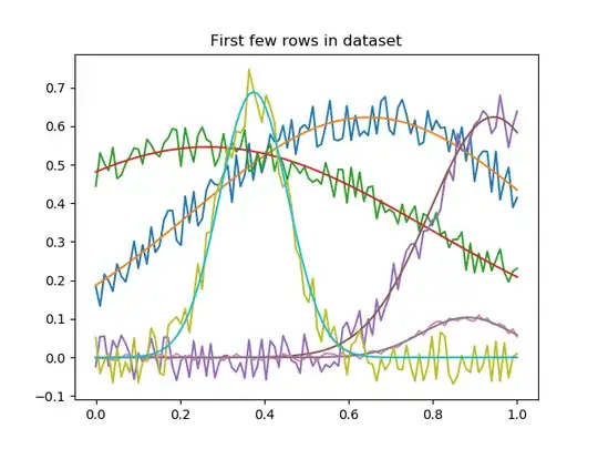

Here's an example generating the kind of data I'm talking about:
import numpy as np
import matplotlib.pyplot as plt
Nr = 2000
Nx = 100
x = np.linspace(0,1,Nx)
f1 = lambda x, a, b, c : a*np.exp( -(x-b)**2/c**2) # An example function
f2 = lambda x, a, b, c : a*np.sin( x*b + c)        # Another example function
prange1 = np.array([[0,1],[0,1],[0,.5]])
prange2 = np.array([[0,1],[0,Nx/2.0],[0,np.pi*2]])
#f, prange = f1, prange1
f, prange = f2, prange2
data = np.zeros((Nr,Nx))
parms = np.zeros((Nr,3))
for i in range(Nr) :
    a,b,c = np.random.rand(3)*(prange[:,1]-prange[:,0])+prange[:,0]
    parms[i] = a,b,c
    data[i] = f(x,a,b,c) + (np.random.rand(Nx)-.5)*.2*a
plt.figure(1)
plt.clf()
for i in range(3) :
    plt.title('First few rows in dataset')
    plt.plot(x,data[i],'.')
    plt.plot(x,f(x,*parms[i]))
Given data, could you train a model on half the data set, and then determine the a,b,c values from the other half?
I've been going through some sklearn tutorials, but I'm not sure any of the models I've seen apply well to this type of a problem. For the guassian example I could do it by extracting features related to the parameters (e.g. first and 2nd moments, %5 and .%95 percentiles, etc.), and feed those into an ML model that would give good results, but I want something that would work more generally without assuming anything about $f$ or its parameters.

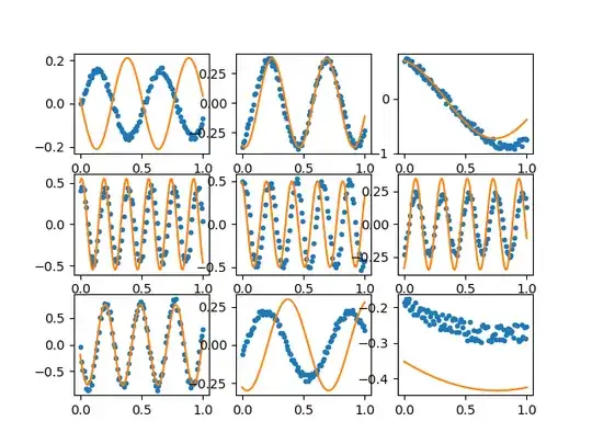

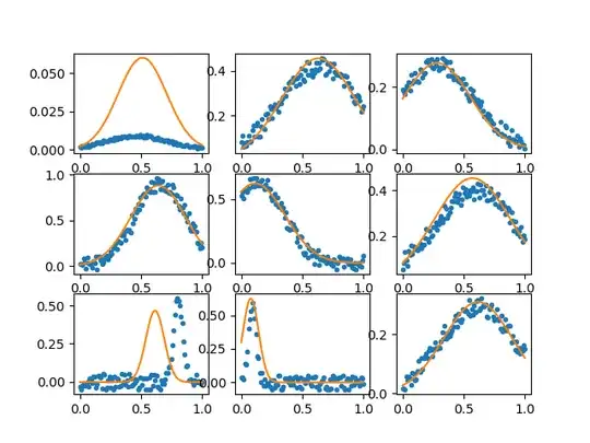

While John's answer I think gives a better idea of which direction I might want to go to seriously tackle this, it turns out that just throwing the data straight into some sklearn algorithms does work better than I thought it would. For example, the following produces ballpark results for the model parameters (for the two model cases I tested), without assuming (explicitly) anything about the model itself:
from sklearn.ensemble import RandomForestRegressor
from sklearn.model_selection import train_test_split
from sklearn import metrics
Xtrain, Xtest, ytrain, ytest = train_test_split(data, parms, random_state=1, )
model = RandomForestRegressor(random_state=1, n_estimators=15, n_jobs=7)
model.fit(X=Xtrain,y=ytrain)
ypred = model.predict(Xtest)
print(f'i={i} ' + str([metrics.explained_variance_score(ytest[:,i], ypred[:,i]) for i in [0,1,2]]))
plt.figure(2)
plt.title('Guessed parameter fits')
plt.clf()
for i in range(3) :
    for j in range(3) :
        plt.subplot(3,3,i*3+j+1)
        plt.plot(x,Xtest[i*3+j],'.')
        plt.plot(x,f(x,*ypred[i*3+j,:]))
plt.show()
Results
Gaussian curves, explained variance for a,b,c parameter guesses (1.0=perfect everytime):
[0.8784556933371098, 0.9172501716286985, 0.8874106964444304]
Sin curves, explained variance for a,b,c parameter guesses
[0.8190156553698631, 0.9757765139100565, 0.7551784827108721]
Here's some plots of from the test sets, along with the original model evaluated with the guessed parameters.
Example plots Example plots
